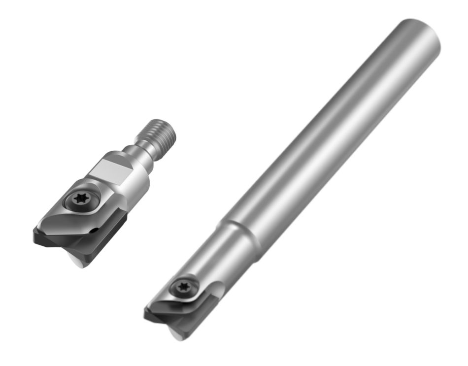

The indexable milling solution with ball nose (KDMB) and toroidal (KDMT) style inserts are ideal for any roughing and finishing copy milling application.
KDMB - Ball Nose Style
- Ball nose inserts for 3D copy milling applications.
- End mills with steel and carbide shanks. Straight, necked, and tapered shank styles.
- Tapered shank styles are ideal for 5-axis machining.
- Screw-On cutters for short projection length applications,
with through coolant. - SF Geometry - The SF geometry is designed for fine finishing applications. Applicable on steel, and hardened materials up to 65 HRC. Ideal for die and mold applications.
KDMT/KDMS - Toroidal Style
- Toroidal inserts for flat bottom applications and undercuts.
- Well suited for high feed applications.
- End mills with steel shanks, and carbide shanks with through coolant.
with through coolant. - Also applicable on lath machines with solid ER collets
for turret adapted clamping units. - Square style inserts for 90° shoulder capabilities.
