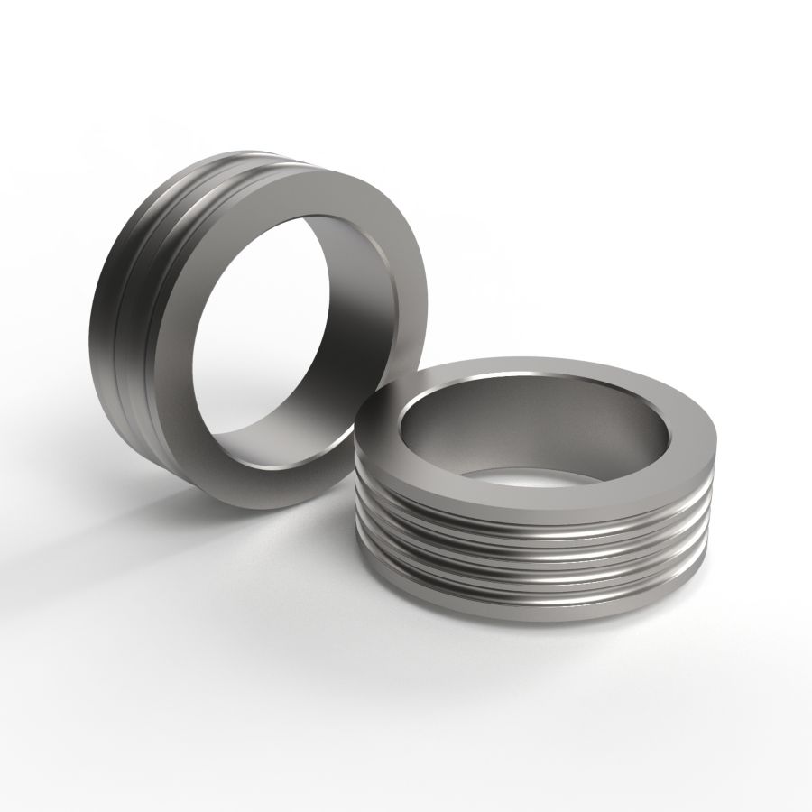

Kennametal manufactures mill rolls from cemented tungsten carbide grade tailored for the demanding environments of hot mills that produce wire rode and rebar.
We deliver mill rolls as semi-finished rolls with ground inner diameter and thickness, or rolls fully finished to your drawing. These mill rolls are manufactured in dimensions of up to Ø400mm outside diameter and a maximum thickness of 200mm.

Kennametal composite mill roll assemblies are designed for use in the high torque, low speed (<10m/sec), intermediate strands of wire rod mills where traditional cast iron or PM steel rolls are used. These roll assemblies are supplied in two axial clamping systems – a traditional hydraulic clamp and our new mechanical clamp that’s easy to install and maintain. Our mechanical clamp provides clamping forces equivalent to hydraulically clamped assemblies, but without the need for specialized tools or fluid.
Kennametal’s new Patented Mech-Lock Combi Roll brings cutting edge technology to run for years. Intermediate stands requirement of rolling of wire and rebar is met with carbide grades RCV5 & RCV6, best suited for Combi. We take key initiatives to make Combi, a running success story at demanding environments. Kennametal partners with customers for its effective implementation.
