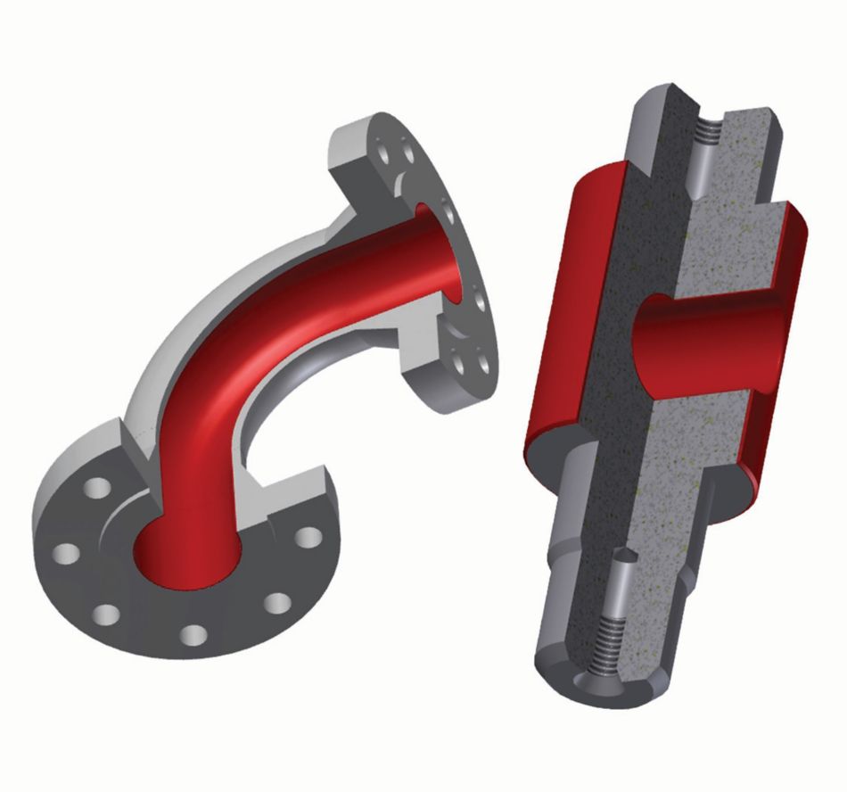

Protect Unreachable Areas
Cladding can be applied to complex geometries, inside diameters smaller than 1", and to other areas unreachable by standard methods.
Range of Coating Operations
Maximize piping and elbow life by selecting the material best suited to deal with the fluid or media being conveyed. Available coating options are specifically designed to solve most wear problems — from corrosion to severe abrasion.
High Surface Quality
Certain Stellite™ substrate combinations allow for crack-free coatings, prohibiting corrosive fluids from reaching the substrate, substantially increasing conveyance system life.
Smooth “as applied” surface minimizes efficiency losses inherent with other types of protection.
High Coating Quality
Conforma Clad coatings are pure, uniform, and dense, with consistent properties through the entire coating thickness to ensure ongoing reliable performance and predictable wear.
The metallurgical bond ensures Conforma Clad coatings will not flake or chip off, even under extreme conditions. No unexpected performance changes in operation due to loss of protection.
