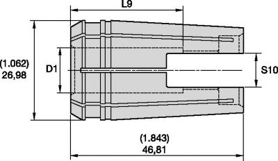

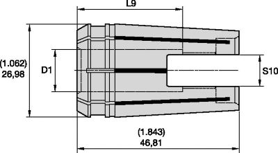

特徴と利点
For 75TGSTC, rubber-filled slots seal collet for coolant-fed tool applications.Can be used in all standard TG collet chucks.Provides Tremendous Grip (3:1 advantage) and accuracy for all drilling applications.Industry-standard ERICKSON™ single-angle collet system.0,13mm (.005") range of collapse.Grips on back taper and margin of drill for maximum feed rates and more accurate holes.Slot in back of collets acts as a drive for the tap square.Manufactured to DIN 6499 Class 2 accuracy.
