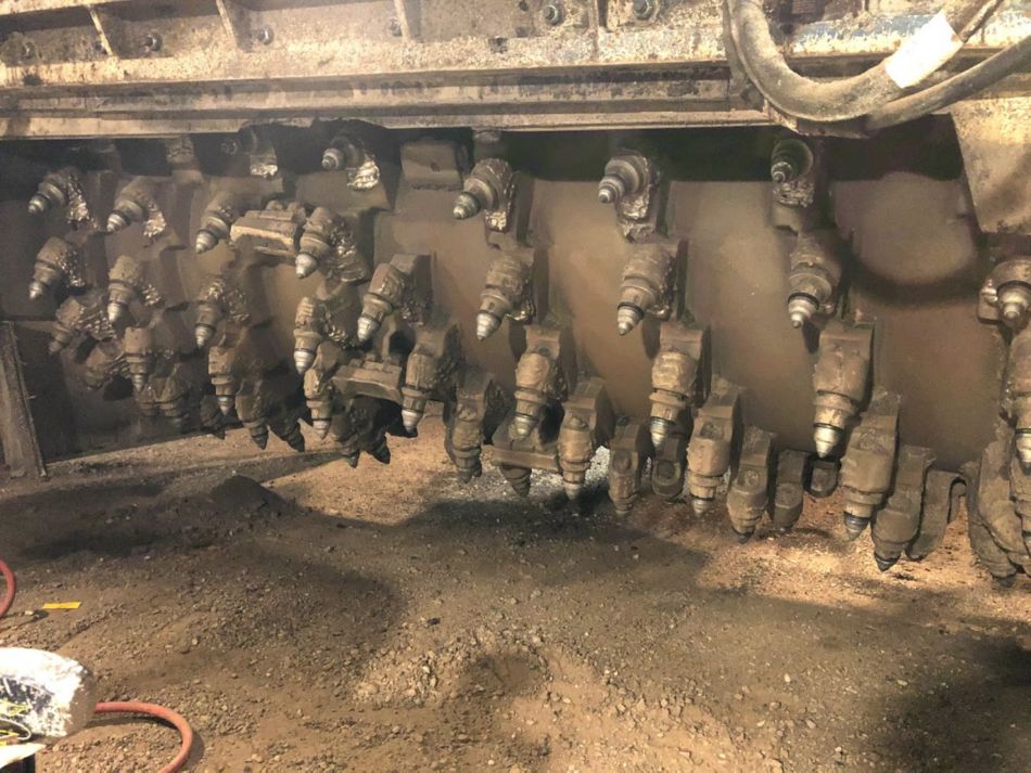

There is more volcanic rock on the west side of the United States, so it is more abrasive. Since this asphalt is so abrasive, customers want to see a longer lasting tool, that does not require as much maintenance and they do not have to change out every day. If a customer must change out a whole drum that is 260 tools at $5 a tool, it gets expensive. That is a direct cost for a customer of approximately $1,300 a day.

BLAISE NELSON: No. In addition to our larger clients, we have seen a lot of success with customers who own one to three machines. Last month I worked with a customer who owns two machines. With a lower number of machines, they could not dedicate a machine specifically to highway jobs. With PCD we were able to give the customer the ability to go miles and miles, but then change out their diamond teeth and put in carbide teeth. This flexibility is a benefit to the customer, because changing static diamond can take a customer at least an entire day if not three.

BLAISE NELSON: It is important to help customers understand the long-term benefit of a longer-lasting tool, compared to the short-term cost differential. While PCD tools have a higher upfront cost versus carbide tools, there are still direct savings achieved by using PCD tooling. The main factor contributing to these cost-savings is the time saved from changing out tooling. Carbide tooling typically needs to be changed out 7-8 times more often than PCD tooling. By using PCD, the operators’ time underneath the machine is reduced significantly.  This not only enables them to save time and money on their current job, but also take on more jobs as a result of the time savings. Customers who use PCD tooling are also getting better production through fuel savings and safer working conditions.
