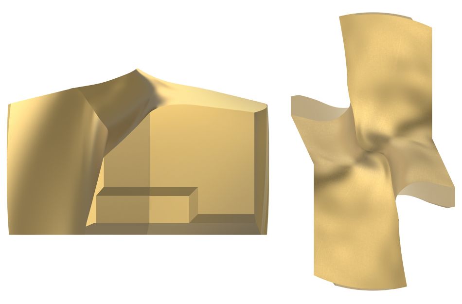

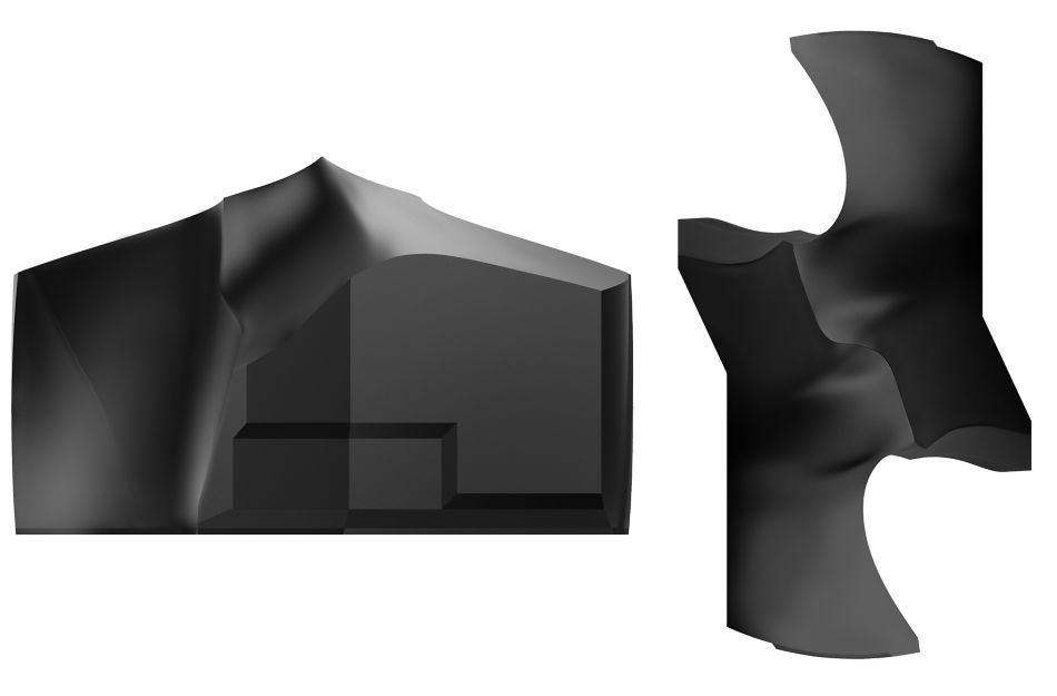

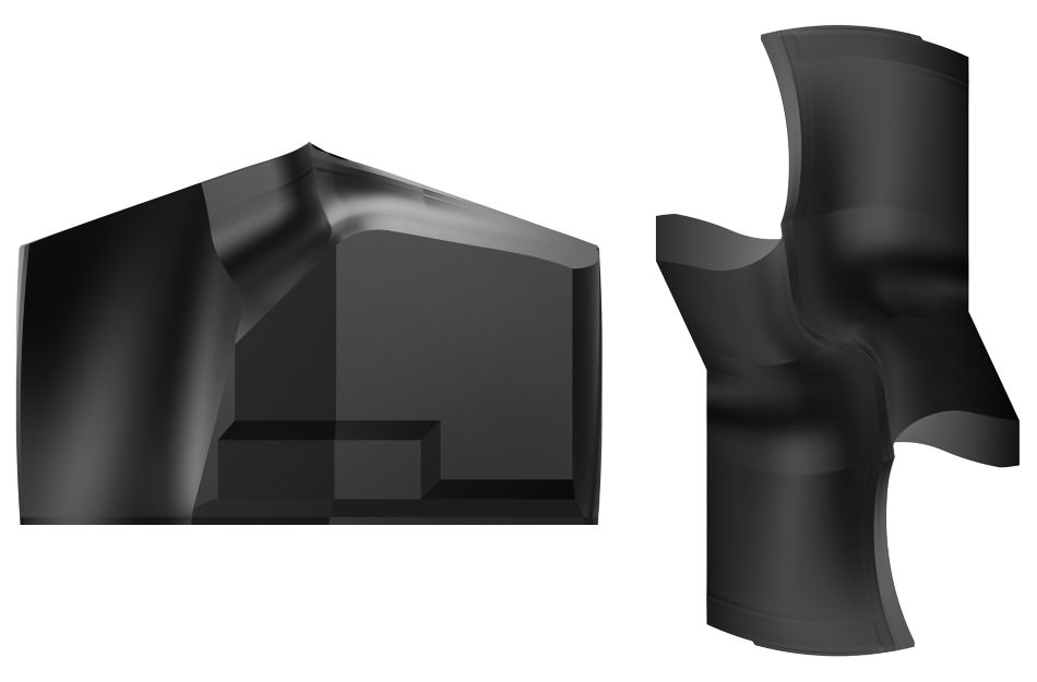

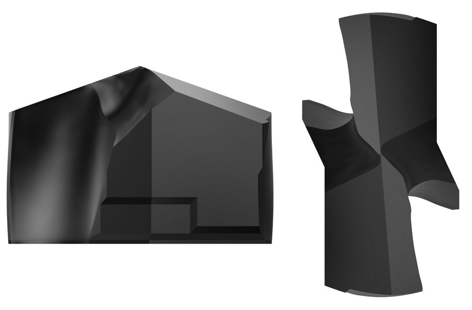

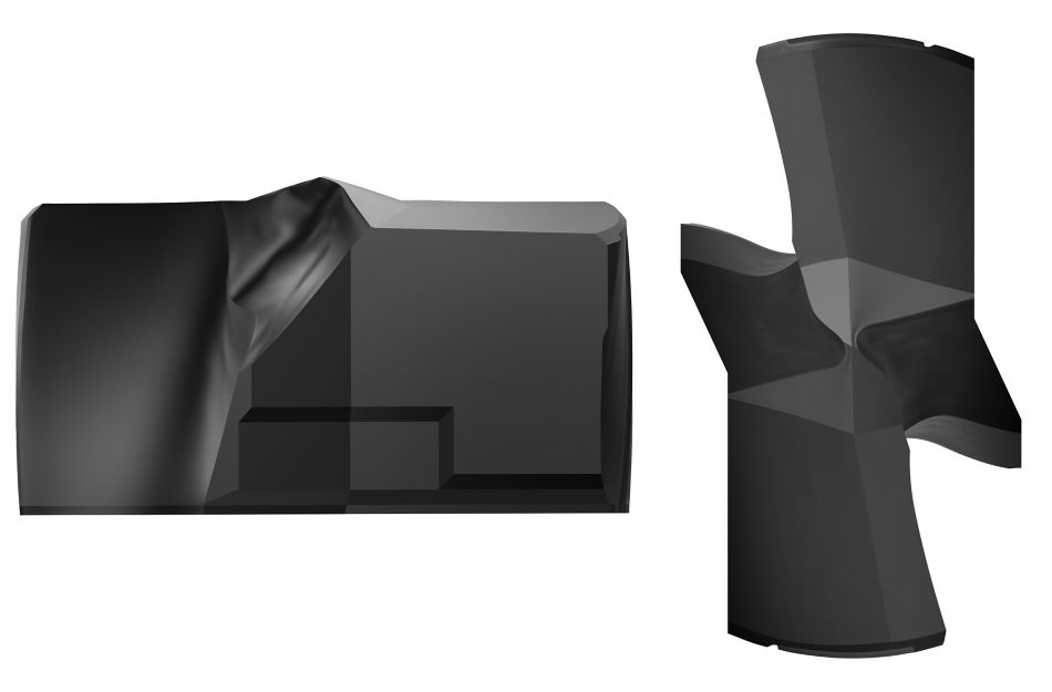

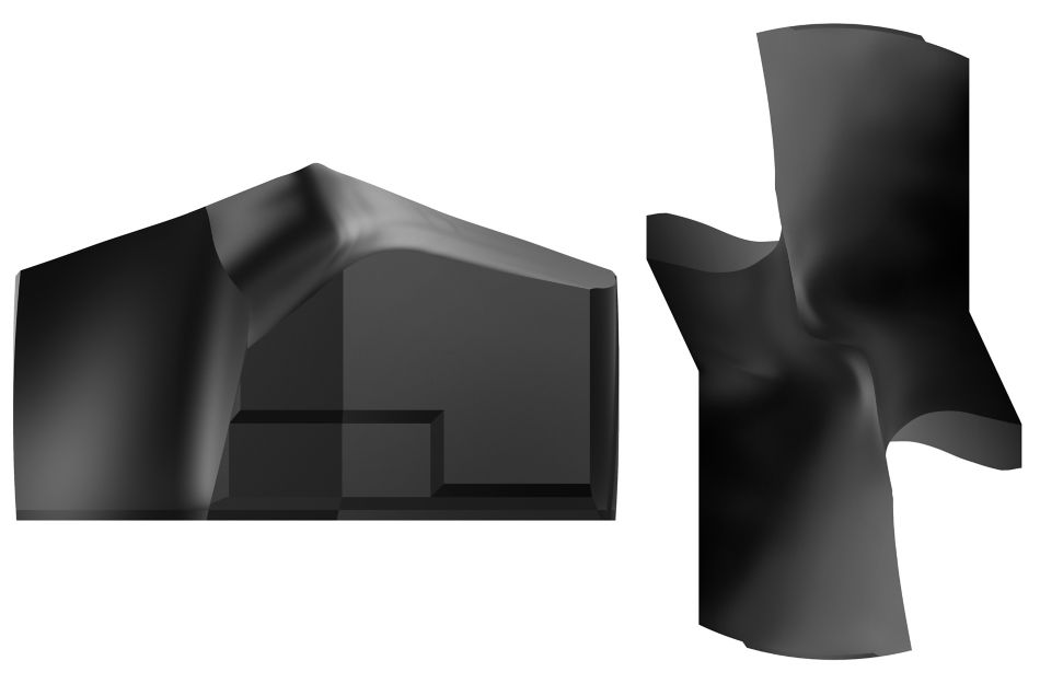

  • HPCCL geometry for cast iron. With corner chamfer for wear protection and smooth hole exit. Four margin lands for perfect hole straightness.
  • HPG geometry for alloyed steels. With straight cutting edge for maximum stability in short chipping steels and interrupted cuts.
  • HP geometry for long chipping steels. With curved cutting edge for optimum chip formation.
  • HPL geometry for stainless steels. The innovative cutting geometry creates two chips in each chip flute for perfect chip evacuation.
  • PC geometry for piloting in all materials.
  • FEG geometry for flat bottom hole drilling, and piloting on inclined entries in steels and cast iron.
  • SPL geometry for low cutting forces in high temperature alloys, and non-ferrous materials. Four-facet geometry with four margin lands for perfect centering and hole straightness.
